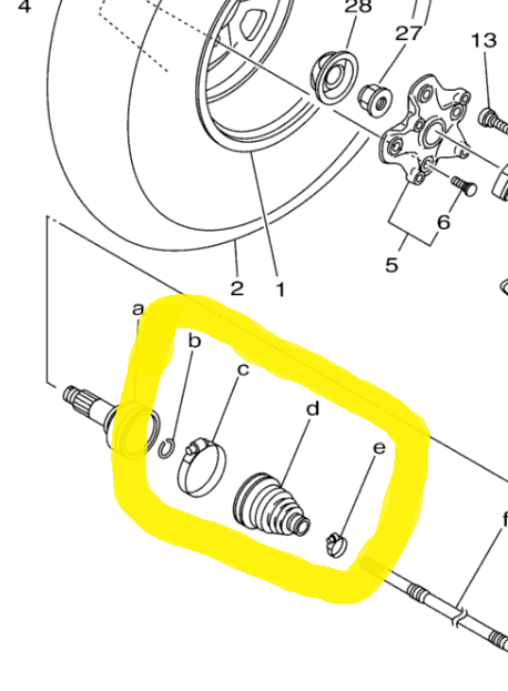

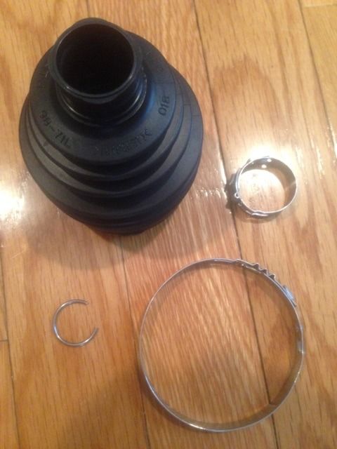

Ordered Yamaha front lower boot replacement kit 28P-2510G-00 which consisted of 5 parts. The 4 parts pictured plus a plastic bottle of grease...
First time doing this and the videos I've seen entail removing the entire axle then removing the top boot to get at the lower boot. Now when putting back together the top boot area (even though the boot isn't being replaced) it's suggested not to reuse the old axle retaining ring but to only use a new ring. So, seeing as how the kit I ordered did not come with the 2 (I believe) retaining rings for the top part of the axle or a second bottle of grease for the top boot it looks like I'll need to order some more parts before I can start on this one. Whadda y'all think?
Looks like I have all the parts (B, C, D, E) I'll need for the lower section...

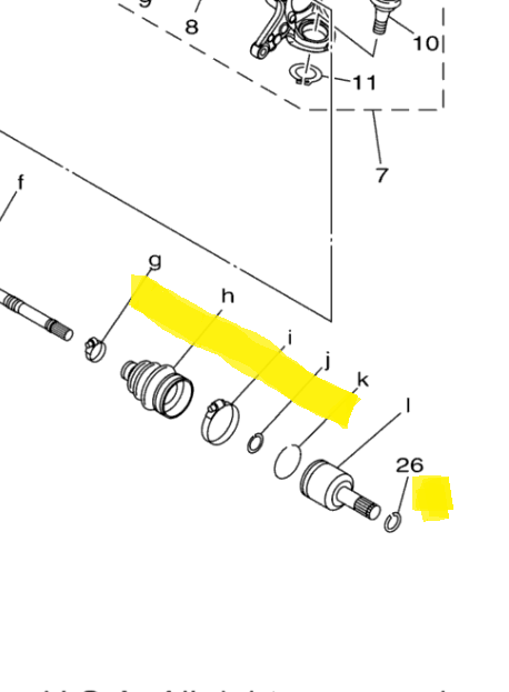

So now I need to get the parts (G, H, I, J, K) for doing the top part...
Also, from what I've seen I think I'll be needing part 26 as well, which I think is an axle retaining clip. So, should I get this part too?

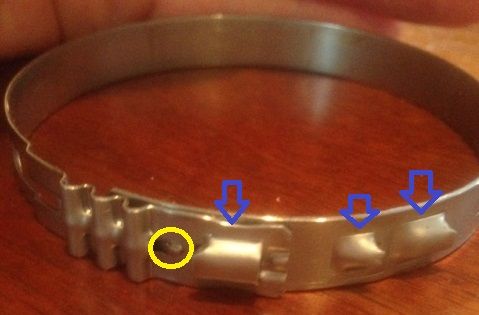

So now on to these boot clamps that came in the kit...
I've seen how other clamps work but not entirely sure about this one. The only retaining barb I can tell that's on this clamp is the little one in the yellow circle. Other clamps I've seen have much larger retaining nubs about the size of the ones with the blue arrows. So I'm guessing for this clamp you use pliers to squeeze the blue arrow nubs together then hook using the small nub in yellow?
