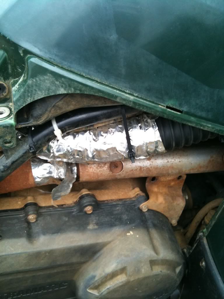

I then wrapped the hose with the heat tape above the exhaust so that it would not melt. I then zip tied it to the frame under the gas tank.

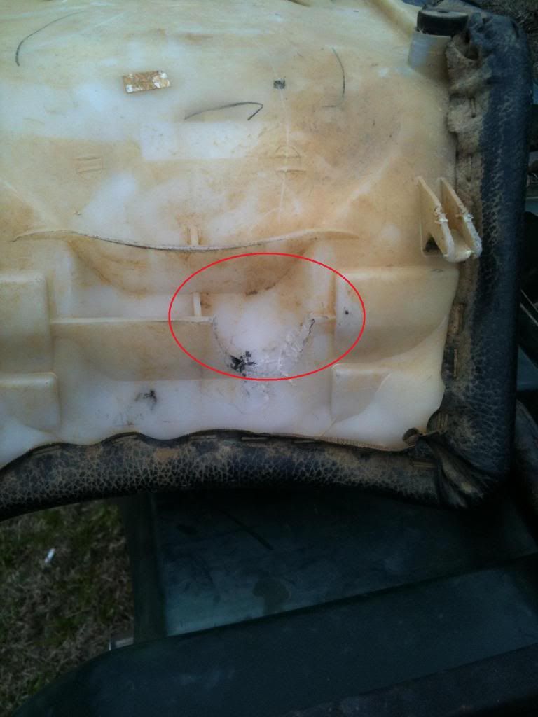

I had to trim a little bit on the seat to get it to fit back on correctly.

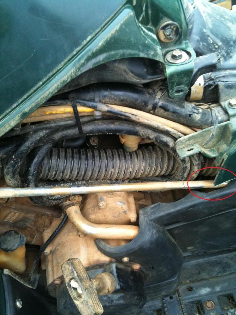

On the left side remove the cover for the oil and disconnect the shifter linkage from the transmission. Rotate it around once so that the linkage sticks out from the bike. The plastic will have to be cut so that the linkage will fit. On the exhaust of the belt I placed some silicone on the motor then slid the 2-1.5in reducer on then clamped it down. I then took one end of the 1.5 in hose and cover it in silicone and stuck it in the one of the 1.5in 90s and put more silicone around it and let it dry. Then I put silicone on the other end of the 90 and stuck it in the reducer and clamped it down. I ran the flex along the left side of the engine parralel to the shift linkage and up to the hole that was cut under the hood.

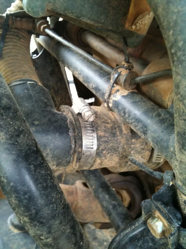

Here is the exhaust hose.
This is how I ran it down the side of the engine. Notice where I had to cut the plastic so that the linkage would fit.
Notice the fuel hose that is rolled up that runs from the cam cover to the airbox. I also extended the vent hose from the rear diff and the overflow from the carb up to the hole under the hood.

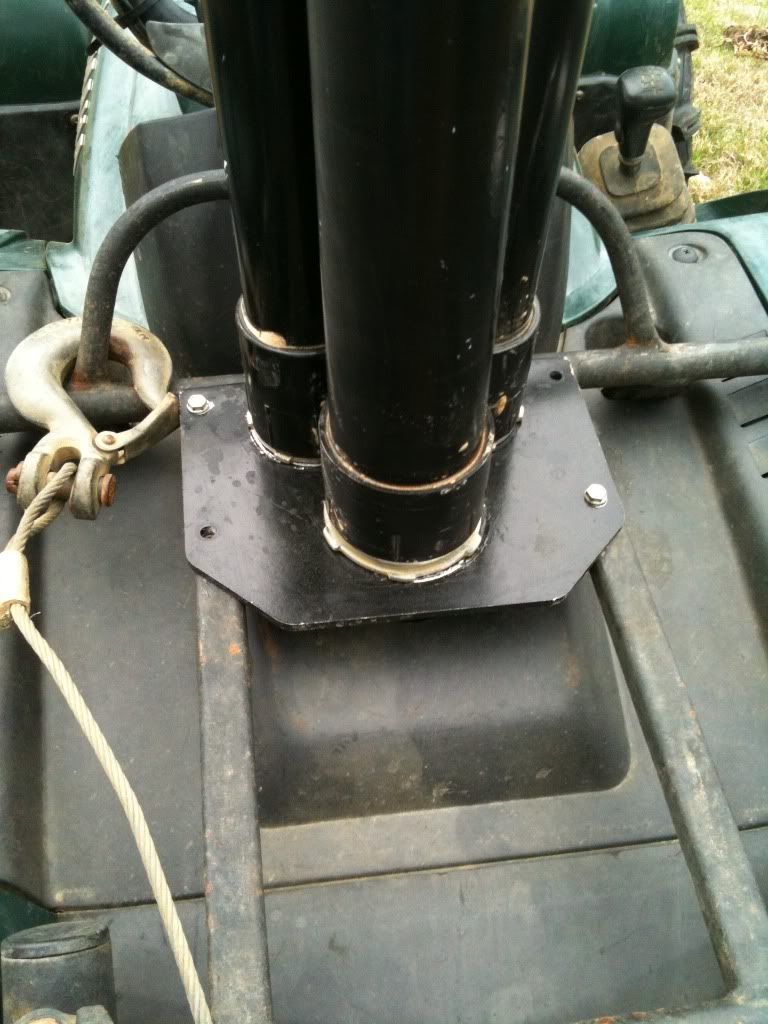

I then cut holes in the metal plate to a way of my liking then placed that on the hood where I wanted to so that the holes would line up. After cutting the hoses long enough to reach the top of the hood I clamped them to the hose fittings and applied silicone around the end to seal off. After putting the hood on, Pulled the fittings to the metal used lock rings to secure it to the metal plate then screwed it down. Screwed the metal to pvc fittings on then glued pvc in place that was cut to desired link. Then slipped the elbows on top. Unscrewd then painted black and put back on. While I had the hood off I brought the diff vent hoses under the pod placing the acordian thing under. I brought the carb overflow up with through the hood and metal with as high as the pvc.

It works great now. The only problems I have had is the airbox hose got a hole burned in it from the exhaust so I put the heat tape on and no more problems. And the 2" x1.5" fitting on the belt snorkel did nit fit well they are not all made the same I went through a couple before I found one that worked then I had to glue it on with black silicone gasket maker.
