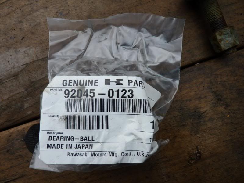

Parts Needed
-Rear wheel bearings: I used Kawasaki part# 92045-0123. Its the same bearing Yamaha uses but a fraction of the cost. I paid about $11 at my local Kawie dealer.
-New hub nuts: Optional depending on condition. Yamaha part# 90179-20006-00 I paid $6.84 a piece at my dealer

Great pics and tutorial! It is very nice that you included a close up of the bearing numbers (Koyo 3055W) as these are often missing in other tutorials. Somebody can use that info to cross reference a more standard bearing at a bearing supply shop.
