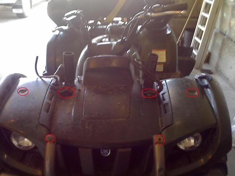

Step - 1: Remove the front rack by removing the two bolts in the top of the bumper, the two fender support bolts, and the two rearward bolts (need a long extension).
- 2: Remove (or pop up if you have snorkels routed through it) the front "hood" by removing the two bolts in the rear outer corners, the popping it off.

I have seen guys asking questions about this kinda stuff before, so someone will get use out of this kinda info.
Changing your cooling system coolant.
Tools and items: Basic sockets, a long extension, a screwdriver, channel lock/water pump pliers, big bottomed drain pan, Coolant
Time: 1-2 hours (+ time to run to town if you are testing your rad cap)
Difficulty: Easy, just takes time to fully flush out the system
Application: All Years Grizzly 660
Warning - Do not attempt if engine is warm - hot. If the engine is warm, your coolant system may be pressured, and dangerous to open. Start quad, move it to your work location, shut it off (MINIMAL run time)
- Animals love the taste of antifreeze, unless you have a neighbors dog you dont like dispose of it properly as it is poisonous.
